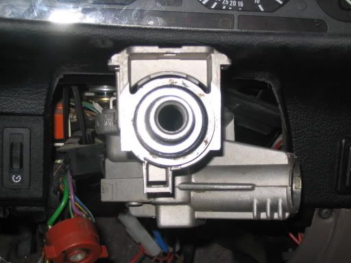

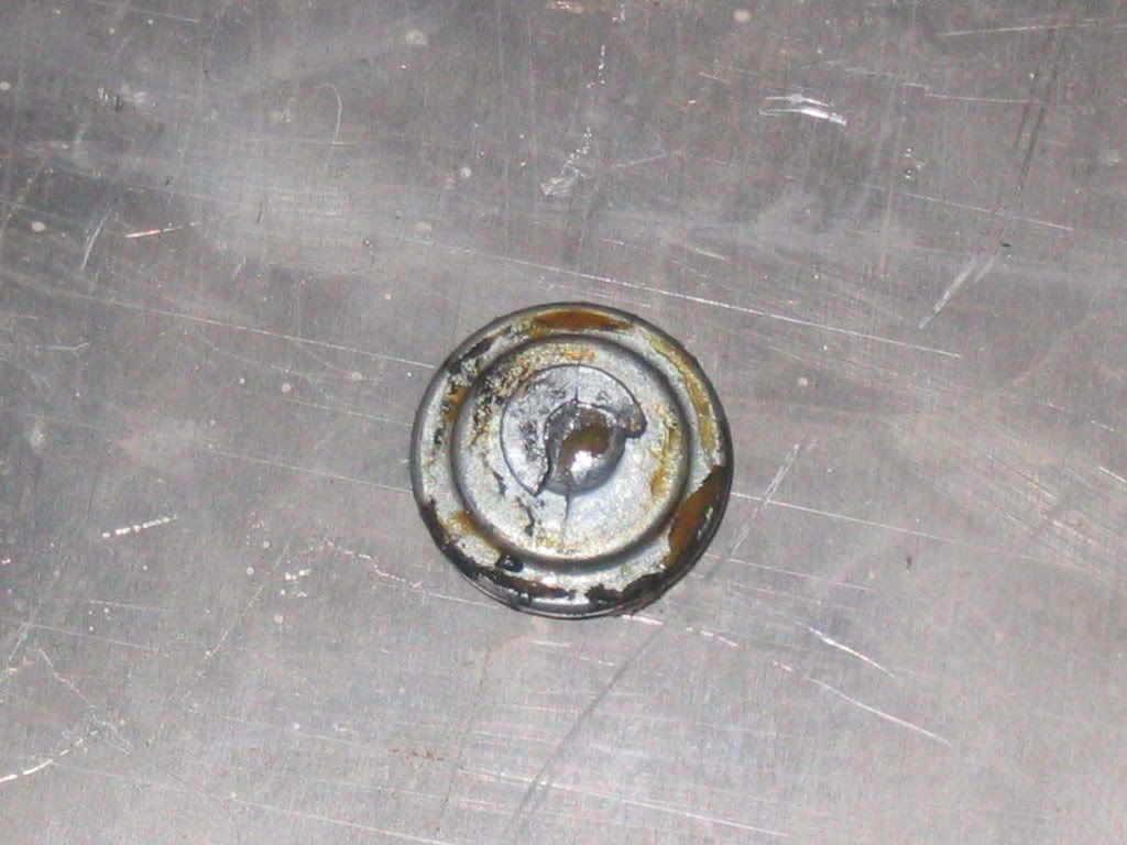

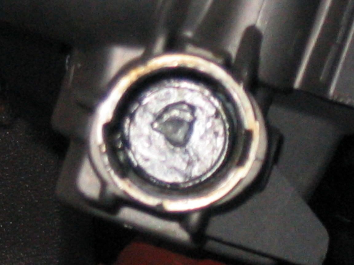

Checked: $153.54
And I am 100% sure this is the problem.
This is your steering column.
This is the inside of your steering lock housing.
This is the piece thats supposed to be inside that steering lock housing.
So to answer the question in the first post, no it is not your key.
