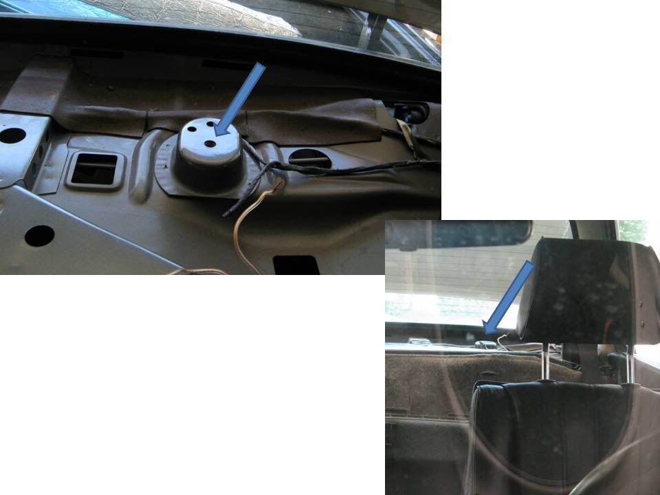

Does anyone know what these are and could they be used to mount a harness. A 5/16 bolt threads in. It could be reinforced too.

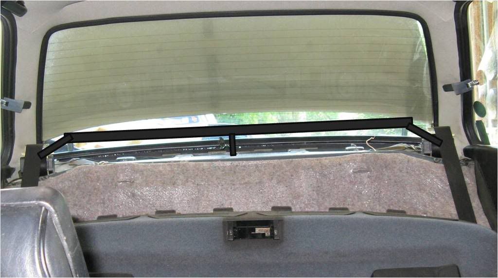

My other idea was fab up a bar that would mount on the upper rear seatbelt mounts.

I would not mount a seat belt to that spot welded bracket, seat belts use high strength reinforced mounting plates, bolts, and washers.

so does anyone have any suggestions about installing harnesses. Looks like i'm going to fab up a harness bar.
